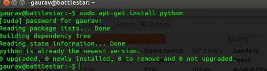

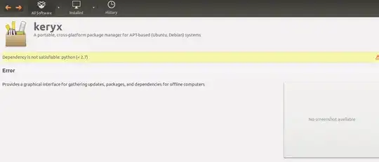

Its shows me error that I am not having python.But I am having that
Installing these application doesn't meet dependencies. The key point here is

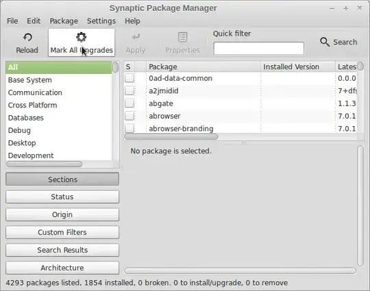

  2. Then open Synaptic Package Manager. Push the button Mark All Upgrades.

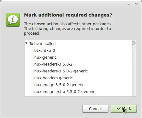

  3. When asked if you want to Mark additional required chanages, press the Mark button.

  11. Open the synaptic and clickEdit->add cdrom It will display a dialog box , Don't click on it
  12. Return to terminal and run
    sudo mkdir /media/cdrom
    sudo mount -o loop /path/to/iso /media/cdrom
  13. Now press ok button on the dialog generated from synaptic in step11 ,
  14. Press Mark all upgrades , Apply buttons ,respectively

To install ubuntu-restricted-extras type in terminal
sudo apt-get install ubuntu-restricted-extras
To install Python type in terminal
sudo apt-get install python
this should solve your problems in installing keryx
Here you can find a tutorial for keryx it states in simple steps how to do the job.
