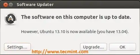

Open 'Software Updater':

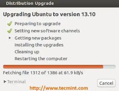

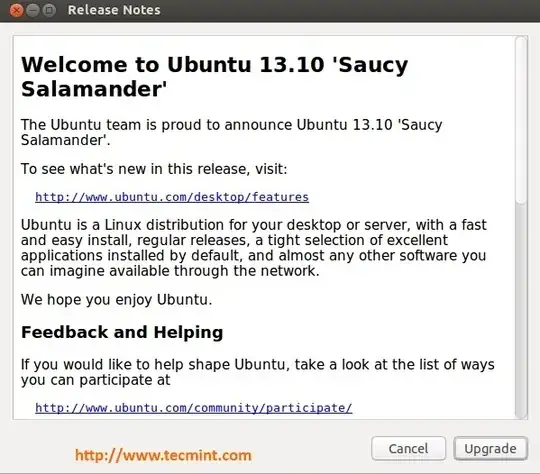

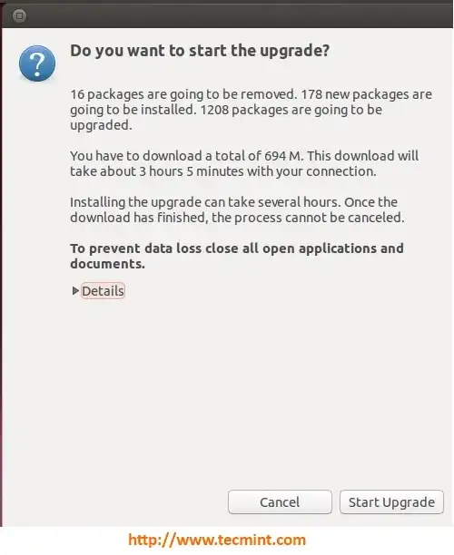

Press 'Upgrade':
It should then prompt this - Start the Upgrade... enter image description here

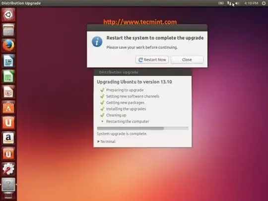

...wait a while...
and reboot.
