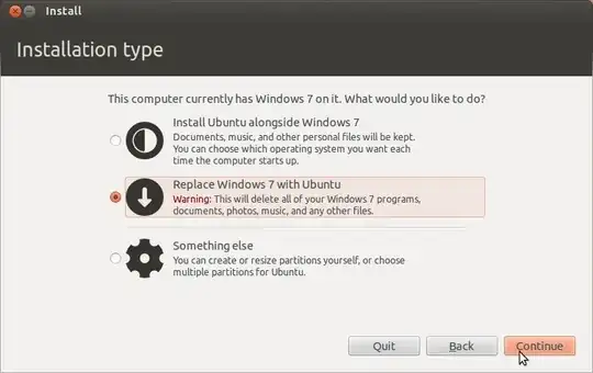

Just download the iso file, burn it on any dvd or usb media. Then restart your computer from that particular media. You will get option to install ubuntu in different way. If you want replace windows 7 with ubuntu, you need to choose the option "erase every thing and install ubuntu". There is lots of other option you can explore them.

  1. I recommend to install Ubuntu using the CD or USB installer. For both, you should download the corresponding .ISO file from the Ubuntu Download page and either burn it to DVD (or CD if you have an empty one big enough) or follow the Ubuntu bootable USB guide. I advice against using WUBI, since WUBI will install Ubuntu on the current Windows partition along Windows.
    During installation, (at least if everything goes OK) the Ubuntu installer will ask you if you want to install Ubuntu along Windows, or if you want to overwrite Windows. Dialogue to select partitioning scheme
