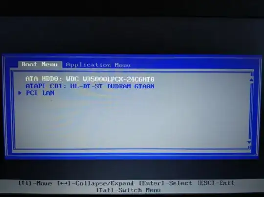

While trying to start my Lenovo laptop I get the screen you see in the image below, I’m not able to to do any other thing or get the Ubuntu console. Also I'm not able to start using the Ubuntu CD.
I think, that your keyboard is broken. I had similar problem with my Lenovo. Try to check with external keyboard via USB. Also check buttons delete, F2, F8, F12 or another, which could start this menu. One of this button can be mechanically pressed.
If this screen happen all the time you boot your laptop one time boot option/ key might be pressed . Meaning F12 key might be crashed. Check if this happen to your key board. But if every thing is ok, then choose the first on the list /ATA HDD0/ and enter. If this works, the rest will be easy.
