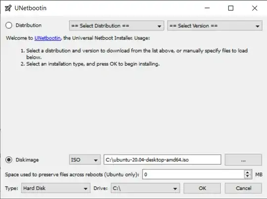

UNetbootin Frugal Install
You can use a UNetbootin Frugal Install, https://sourceforge.net/p/unetbootin/wiki/installmodes/, to create a temporary Ubuntu Live install on the corner of your Windows hard disk. You can boot this frugal install and use it to install Ubuntu to unused space on the same hard disk.
In UNetbootin select Type: = Hard Disk. On the next boot after installing Ubuntu, you will be given the oppertunity to remove the frugal install completely.
