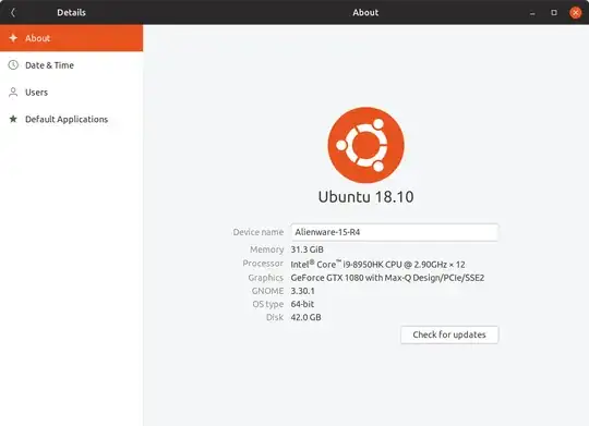

An image showing the NVIDIA GTX 1080 driver fully loaded:
Image showing NVIDIA GTX 1080 driver fully loaded
