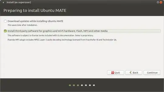

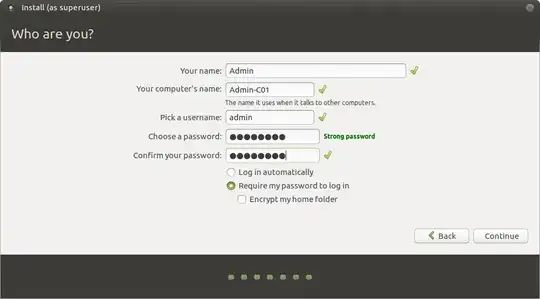

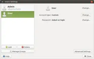

Ubuntu and its variants are all easy to install. I'd recommend Ubuntu MATE for your computers. During the install process, create an admin user (with a strong password). Then, when you start the machine up, add a user with standard (or custom) privileges.
Ubuntu is excellent for user restrictions. Everything is locked down - users cannot install or remove programs, they can't delete critical system file and they can't change system wide settings. You can even limit their access to printers and external media.

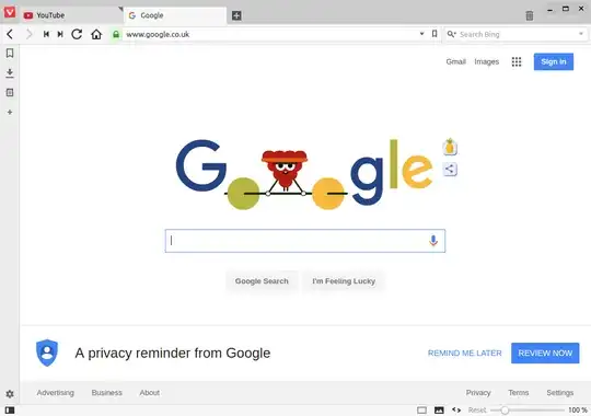

Web Browser:
Have a look at Vivaldi. It's a new browser with some really advanced features, that just works. It has an easy setup, and comes with Flash as part of it (the latest version), so you can play online games and watch videos.

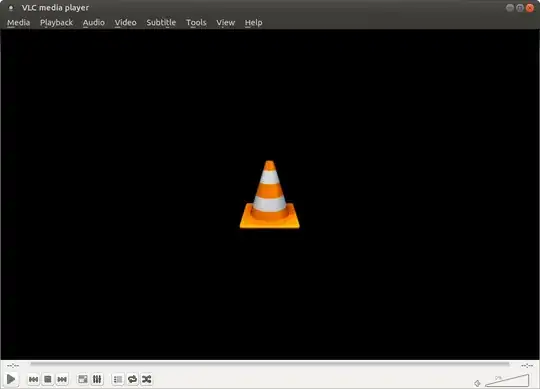

Video Player:
Ubuntu MATE comes with a free and open source video player - VLC - installed by default. Just make sure you check the "Install non-free components" during the installation.

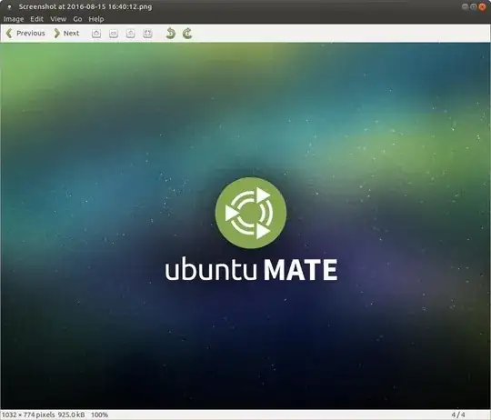

Photo viewer
A photo viewer - eye of MATE - is included by default. It can open pretty much all image files.

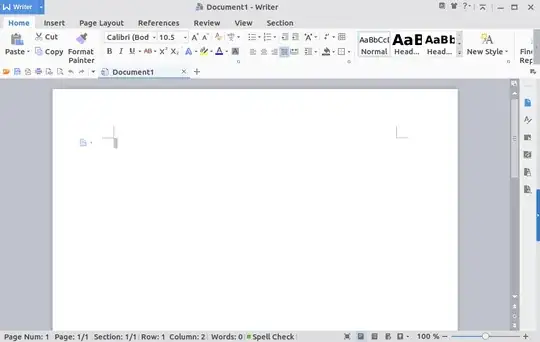

Ubuntu comes with a free and open source office suite - libre office. However, compatibility with Word, Excel and PowerPoint is lacking and the GUI hasn't changed in 10 years.
I use WPS office on my computer - it looks very much like Microsoft office, and it will save as a .docx, .xlsx and .pptx very well.
