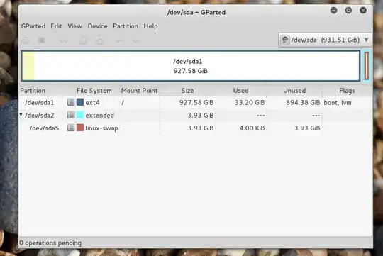

I lost all partition hard drive (1 TB). It's completely formatted. Now it's in ext4 file system. I cannot make partition from that 1 TB. I used terminal window and tried to make it as a Linux logical volume manager, but failed.
Image showing my disks in Gparted:

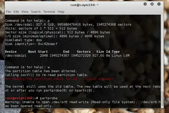

Terminal window making Linux logical volume manager failed while writing:
please help me to fix this....

The message about the kernel using the old table, appears because you are trying to modify partitions on a disk that's in use by the system. Either boot from a LiveCD and make the changes you want on your disk or, as Rinzwind said, do a clean install.
If this disk is not your system disk, you can also unmount it before you start making this kind of changes.
If it is, reboot as instructed by fdisk for the changes to be used.
