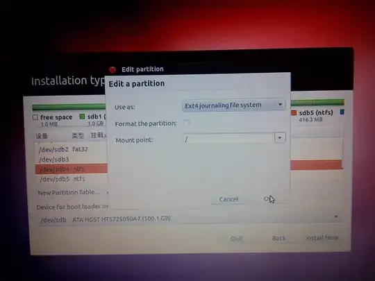

  2. Click "change" button. (there is no "edit" button for me to hit)
  3. Select as shown: enter image description here

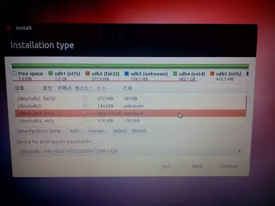

  4. Click "OK", and then I get the following: enter image description here
You can see the sb4 type is changed to ext4. and I dare not click "continue", because I fear it will erase my Windows 8. Also, it did not ask me to set space size, I think this is the wrong step.
And I get stuck. So what should I do?

You can select the partition as ntfs, resize the partition to 470GB. that will leave you 10 GB free space, which you mark as ext4, format it and mount it as "/"
