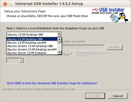

  2. Open up the program, and select your Ubuntu version from the drop-down list. So, for example, if you've downloaded the 32-bit Ubuntu 13.04 Desktop, choose Ubuntu 13.04 Desktop i386.

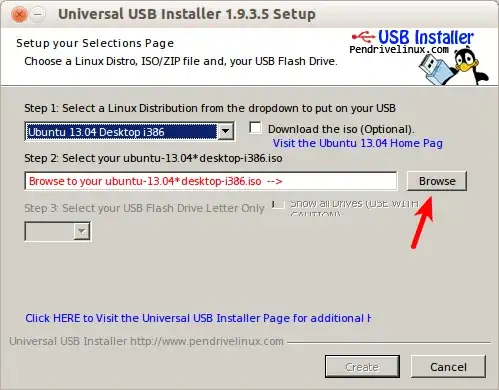

  3. Using the "Browse" button, point to your downloaded .iso file.

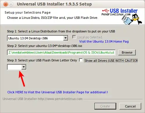

  4. Choose your USB flash drive from the drop-down list.
    Note: make sure you are choosing the correct USB flash drive and that you have a backup of whatever is on it, because the program will most likely delete everything on it.
