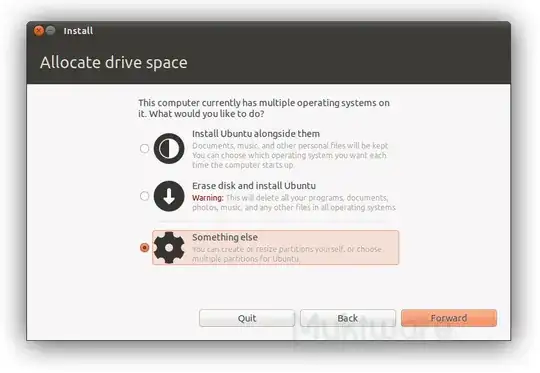

continue with your installation untill u see this like in below image

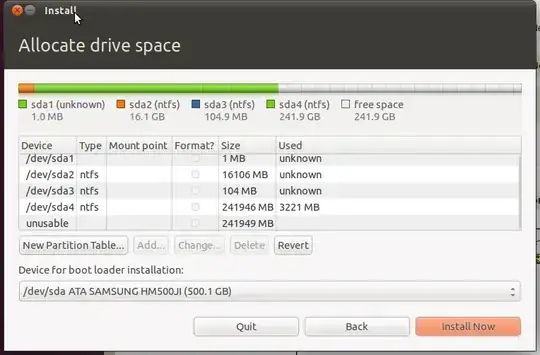

this is very important select "Something else" by selecting this u can select the partition where ubuntu gets installed, after that u will go to
here select your windows 8 partition
identify it with its size, still cant find it then minimize the 'installation window' and press windwos it opens dash type "disks" open disks and see ur windows 8 number under "device number"
then select that partition at the 'installation window' and select 'change' & 'partition type as ext4' & 'mount point as \' & select format
select your hard disk /dev/sda at the "Device for boot loader installation" & install now
