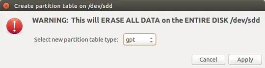

  7. If you don't care about Windows, choose gpt, otherwise choose msdos in the screen below:
  8. Click: Apply on the screen above.
