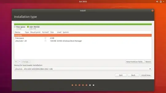

In one of the ~20 tries I have done I could access the partition manager during installation, it said the ssd was 500 GB but only showed a 120 MB partition that occupied 100% percent of the space, really weird:

EaseUS has botched your partition table and Ubuntu is not even able to read it as per your output of parted --list. That Windows is still able to boot is a small miracle but luckily for you, you saw this early on and I'm expecting huge problems if you continue to use the machine in this state.
As you've just reinstalled Windows 10 anyway, do the following in the following order:
  1. Boot Ubuntu Live
  2. Open gparted
    • Device
    • Create Partition Table
    • Choose GPT
  3. Reboot and install Windows (yeah, again)
  4. Boot Ubuntu Live again.
  5. Use gparted to make space for Ubuntu (no need for third-party tools, you're the second one today that botched his system with EaseUS)
  6. Reboot and install Ubuntu
