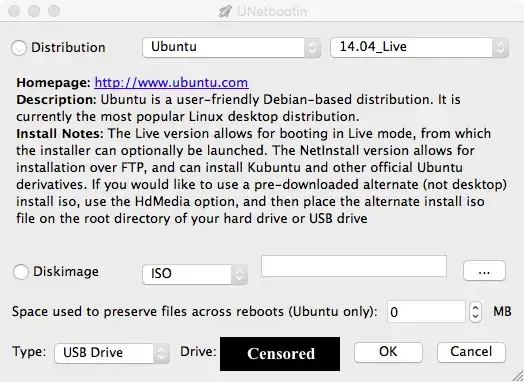

  1. Download UNetbootin
  2. Open UNetbootin
  3. Have your settings set to these:
Step 1
  1. Set Drive to your Flash Drive
  2. Click OK
  3. Remove the flash drive after completion
  4. Plug it into your son's computer
  5. Start your son's computer
  6. Select the flash drive as the boot device
  7. Profit!
