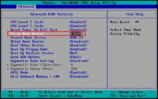

In order to make the system recognize your Ubuntu, you have to change the boot order in bios. After turning on your computer press either F2 or F12 (sometimes it Delete key) and go to bios munu, in the "Boot" tab change boot order. It also could be in the advanced tab.
like this one

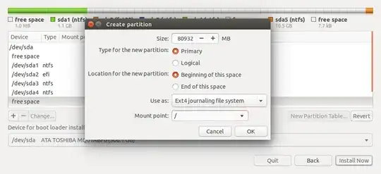

If you want to have your documents on your HDD. You just have to set your HOME PARTITION (/home) on that drive while installing Ubuntu.
In the picture you see a box named Mount Point. Its on Root Partition (/) by default. You can set root on SDD and after that select your HDD and click on + sign and from this box select /home. That will do it.
