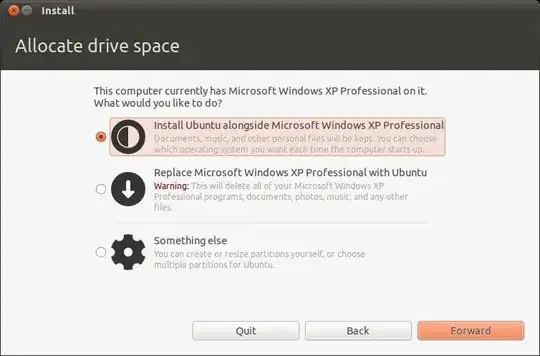

Then move with choices till you reach this window
Now if you want to remove windows You have to choose the second option "Replace Windows with ...."
and that's just move with options and you'll got what you wish...
