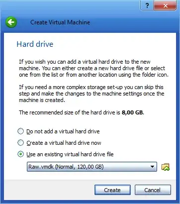

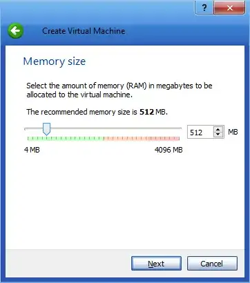

    • Select Machine → New or press Ctrl + N enter image description here enter image description here
    • Attach vmdk file:

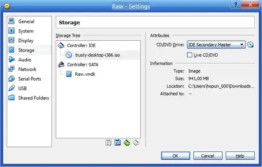

    • Attach Ubuntu ISO file or use physical device enter image description here

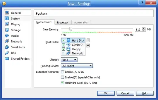

    • Set boot order as shown below enter image description here
    • Click OK to save settings

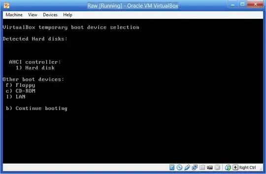

  4. Start Raw and press F12. Choose CD enter image description here
  5. At this point, follow this guide from the step 6. Don't touch existing partition, just install Ubuntu. After Installation you may simply reboot computer and boot into Ubuntu.
