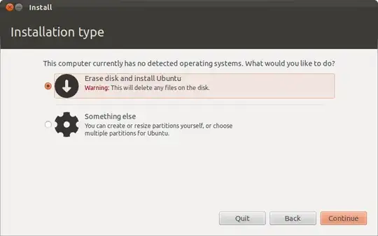

Of course you can. Using the unetbootin software you can create a bootable thumb drive from the ISO. Boot using this thumb drive. On the install wizard, select Erase disk and install Ubuntu option. This is clear out the entire drive and install ubuntu on it. Hope this helps.
