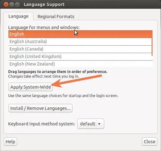

First, go to System SettingsLanguage Support and in Langage tab, apply system wide English:
Language Support

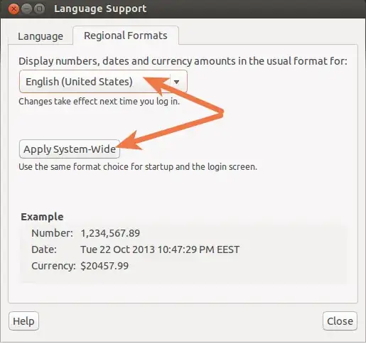

In Regional Formats apply system wide your favorite English:
Regional Formats

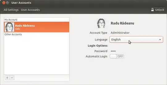

Second, go to System SettingsUser Accounts and select English as your language:
User Accounts

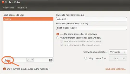

How to change keyboard layout to Finnish
Go to System SettingsText Entry and add Finnish keyboard layout:
Text Entry
