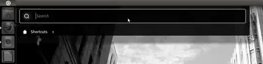

  • First open the dash by either clicking on the Home button (On the top-left Corner) or pressing the Super Key .
  • Search for 'Software Center' and launch the Ubuntu software center.

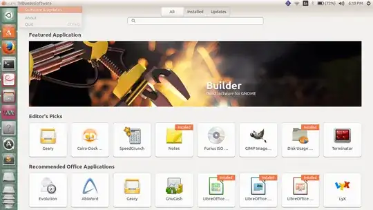

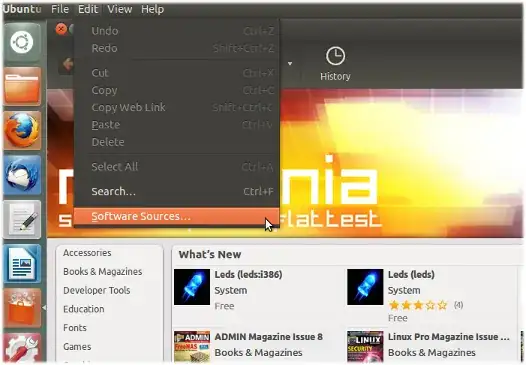

  • Move the mouse to the top panel where the name of the application is written.
  • Now Go to the Edit menu and select Software Sources.

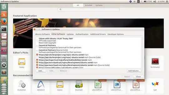

For newer versions, right click and click Software and Updates enter image description here
Then, click Other Software, enter image description here

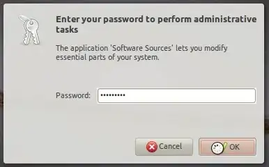

  • Enter your password when prompted.

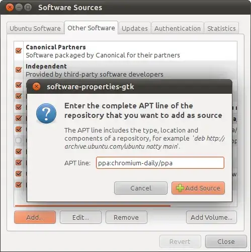

  • Now click 'Add', a box will appear.

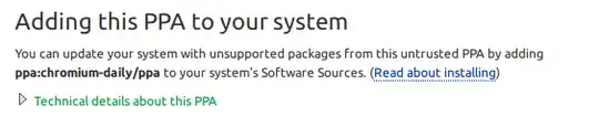

  • You have to enter the PPA in the box. It can be found in BOLD on the launchpad page.

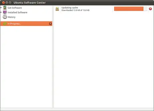

  • Now click 'Add source' and close the Software Sources. The cache will be refreshed

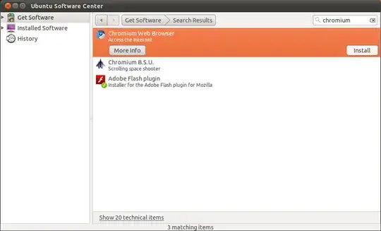

  • Now install the software from the software center.

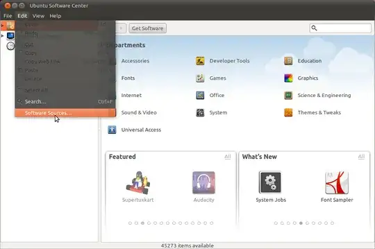

Now in Software Center, go to Edit > Software Sources
menu2

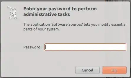

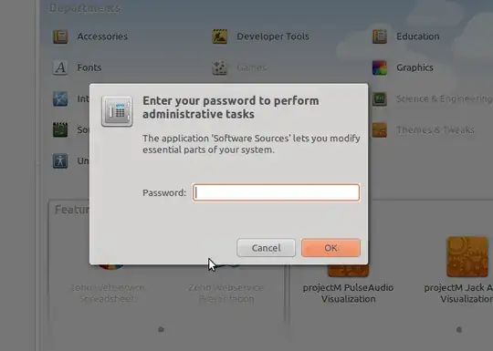

You will be asked to enter your administrative password.
gksu

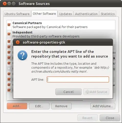

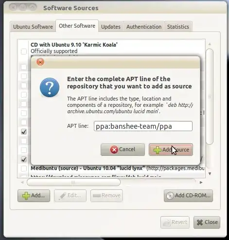

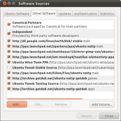

Now in Software Sources open the Other Software tab and press Add.
add
In this dialog, we will enter the PPA's information.
software-properties-gtk

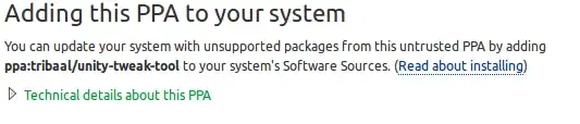

This information is found on the PPA's website in bold under the heading Adding this PPA to your system. For the Banshee PPA, it looks like this:
ppa

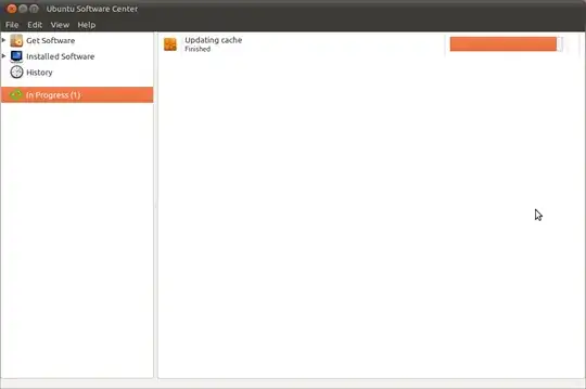

Now we can close Software Sources and Software Center will automatically update so that you can access the new packages from the PPA.
update

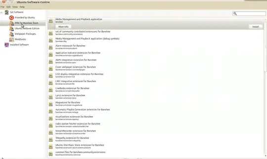

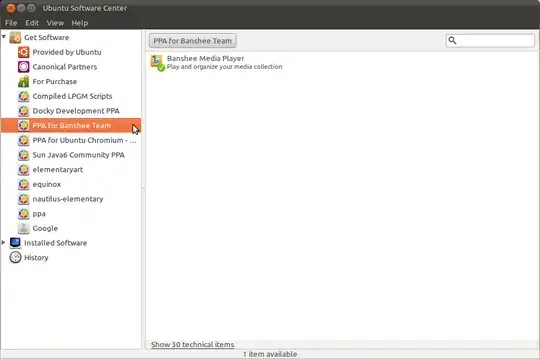

The packages available from the PPA can be seen by expanding the Get Software menu in Software Center's left column.
new

  • You will be prompted for your password. Note that you can only add a PPA if you are an administrator user due to the security risks and system wide consequences of adding a PPA. Enter your password into the dialog to continue:
gksu

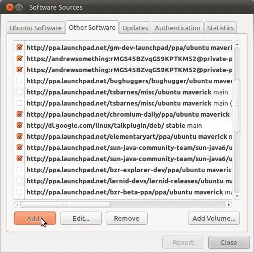

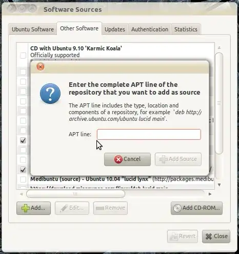

  • In the Software Sources window, click on the 'Other Software' tab and click the 'Add...' button. This will bring up a prompt asking for the 'APT line':
apt line
  • The text to paste into this box is found on the launchpad page in the 'Adding This PPA to your System' in bold letter.
  • Paste the line you copied into the text box in Software Sources (CTRL+V):

  • You can now find software packages from this PPA in Ubuntu Software Centre:
software centre

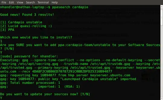

This will add the ppasearch PPA (and its key) and install the package. You can run the script by typing the following command in a terminal:
ppasearch PPANAME
So to find the Cardapio team PPA, you might run:
ppasearch cardapio
As you can see from the screenshot below, you are then presented with a list of matching PPAs. Once you select the PPA you want, it will get added by the script by using add-apt-repository. ppasearch will even run sudo apt-get update for you if you wish to update your sources.
ppasearch screenshot

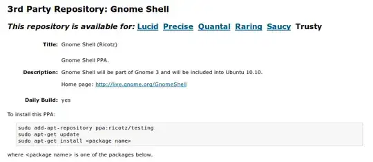

How to find PPA? (Solution when apt unable to locate package)
You can find PPA from launchpad page as suggested in following image:
adding ppa to your system
You can find PPA from Ubuntuupdates -Package Search as shown in the following picture:
adding third party repository
Then Add repository from terminal as following:
sudo add-apt-repository ppa:<someppa/ppa>
sudo apt-get update
