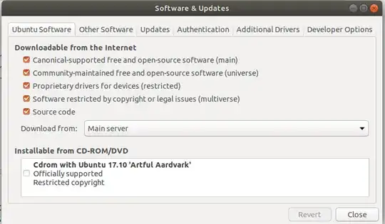

I had just recently install Ubuntu 17.10 and was getting the same error of Hash Sum Mismatch for a some repository.I went to Software and Checked Source as shown below and there were no problems further for downloading repository from the terminal.
My Software and Update Section
