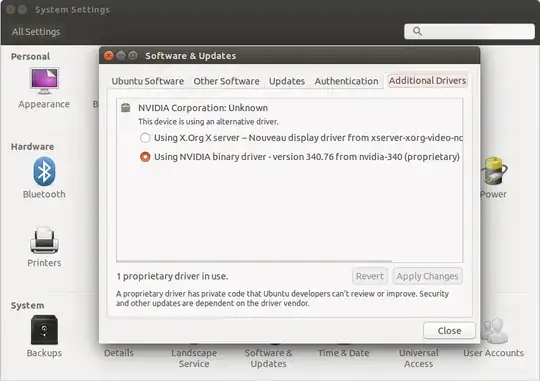

If after that we still had grahics card issues we should proceed using the tested drivers from the official Ubuntu repositories accessible via System settings > Software & Updates > Additional Drivers (proprietary drivers (restricted) repository needs to be activated first):
Here shown for Nvidia
