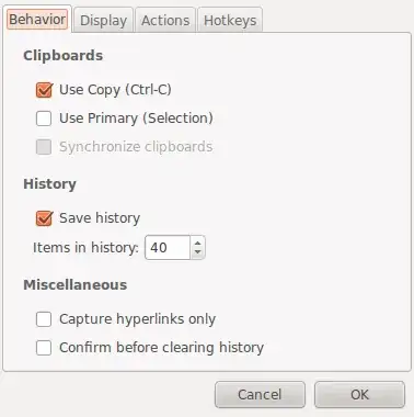

Parcellite
I've used parcellite for many years as a clipboard manager. It runs in the Notification Area and offers many options for managing both Primary Selection and standard freedesktop.org Clipboard.
Tray Icon
It's been my answer to managing clipboard items.
Preferences

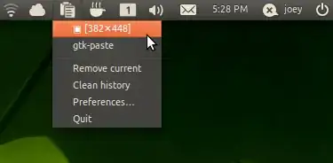

Pastie
A new clipboard manager with Indicator Applet support was recently released (though not in the archive yet). In addition to tracking text clipboard history it will also capture and persist data clipboard entries as well (Files, Folders, etc) which may be useful if you manipulate files a lot via a GUI/Clipboard environment.
alt text
You can add the following PPA: ppa:hel-sheep/pastie

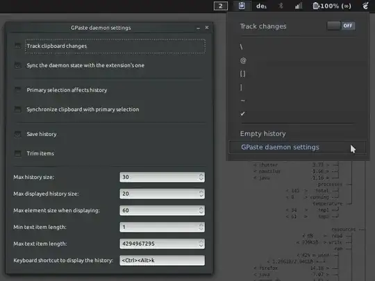

How about GPaste daemon settings, a clipboard management daemon applet with DBus interface:
  • GPaste is a clipboard management suite for GNOME written in Vala
  • GPaste settings look has been updated to better fit with recent GNOME
  • Daemon now fully evenmential (no more polling, less power consuption)
  • GPasteClipboard now has a “owner-change” signal similar to GtkClipboard’s one
  • New setting to set the maximum amount of memory used by data in history
  • FIFO mode has been dropped (lacking design)
  • Code cleanup and modernisation
  • g_paste_history_add is now transfer full
  • g_paste_keybinder_add_keybinding is now transfer full
Installation:
To install it in Ubuntu 13.10, 13.04, 12.10 or 12.04, use the commands below:
sudo add-apt-repository ppa:webupd8team/gnome3
sudo apt-get update
sudo apt-get install gnome-shell-extensions-gpaste
Or install gpaste through synaptic package manager (and also gnome-shell-extensions-gpaste if you use Gnome-Shell).
Another option is the installation through software-center.
