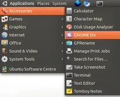

StackApplet is run via a different system. run StackApplet from Applications > Accessories. It will then turn itself on then put itself automatically into the system tray
I don't appear to have StackApplet available in the Accessories menu:
Screenshot showing the Applications > Accessories menu.

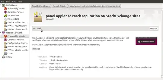

Though I do have StackApplet installed (according, at least, to the Ubuntu Software Centre):
Screenshot of the Software Centre, showing StackApplet is installed.
The problem is that you are running an older version of StackApplet that is no longer supported and doesn't quite work as well.
You can find the new version (1.4.1 beta) in the StackApplet PPA.
