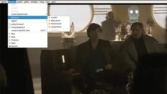

  2. Using SMPlayer or VLC, both of which have the option to Stream to Chromecast
SMPlayer enter image description here
VLC enter image description here

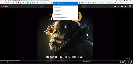

  1. Using Youtube (In Google Chrome):
This helps a lot when you are managing multiple rooms, kids, NetFlix accounts and more. Do note that if Chromecast is not detected, 99% of the time is the network configuration. You can find a lot of helpful advice at the Chromecast Help Page or going to the Troubleshooting Guide.

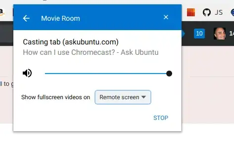

You can also share your desktop by using the Cast option in Google Chrome:
And after selecting any of the Chromecasts you would see something like this:

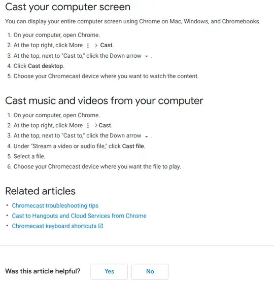

https://support.google.com/chromecast/answer/3228332?co=GENIE.Platform%3DDesktop&hl=en

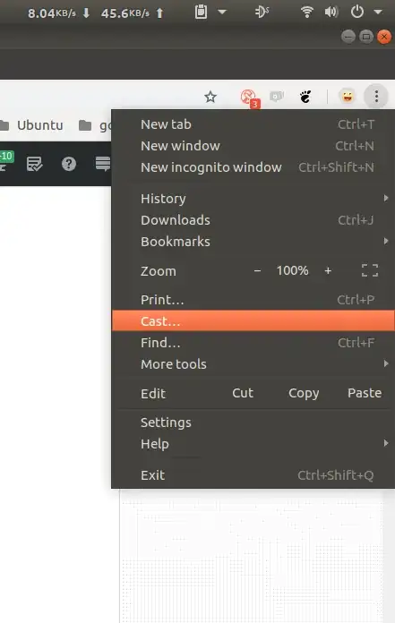

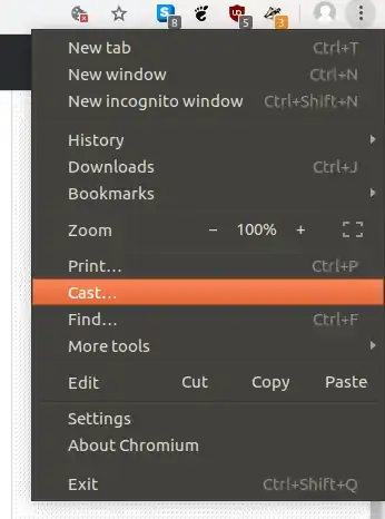

Simply click the Chrome Tools menu in the top right corner of your Chrome browser window. Then click Cast… More detail from google support
