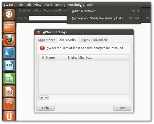

gWaei used to run in 11.10, but in 12.04 I get a blank window to open and it just hangs from there, requiring a force-quit to close.
I submitted a bug to the gwaei launchpad bug report site and while there has been a response, I don't really understand much of it.
Can somebody explain to me in simple English how I can get this thing to work?

Known bug, fixed in Debian, please update from my PPA
This is a known bug with the gwaei version (3.2.0) bundled with Ubuntu 12.04 as you have noted. It has been fixed upstream (i.e. in Debian, where Ubuntu draws its packages from).
I have ported the fixed version 3.4.3 (and dependencies) to a PPA to allow Ubuntu users to easily solve this problem.
Note: If you are unfamiliar with installing third-party software from PPAs, you may want to refer to these questions:
Solution: here's how...
  1. Open the terminal with Ctrl+Alt+T
  2. Type/paste sudo apt-add-repository ppa:izx/bleeding -y
  3. Then type sudo apt-get update
  4. And finally, the below (press Y at the prompt):
    sudo apt-get install gwaei libwaei2 zlib1g
That's it -- gwaei should now work!
