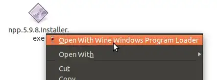

You'll first need to install the Wine Compatibility Layer, it will allow you to run Windows appliactions on Ubuntu:
  1. Open the Ubuntu Software Centre
  2. Search for "Wine"
  3. Install "Wine Microsoft Windows Compatibility Layer"
Next you need to tell Ubuntu that this is a program.
  1. Right click the .exe file and select Properties
  2. Go to Permissions and check Allow executing file as program
Now you can run the program
  • Right click the .exe file and select Open with Wine Windows Program Loader

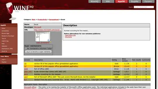

Wine is not a perfect answer, as you will probably many compatibility problems. You might consider first checking up on your application at WineHQ.org. Platinum is the best level, then Gold, Silver, Bronze, and finally Garbage.
