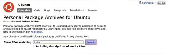

You can search for PPAs matching software or package in the following link
https://launchpad.net/ubuntu/+ppas
alt text
