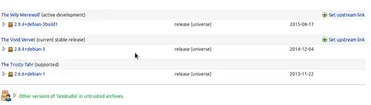

As you can see in the official launchpad source page, the newer version(s) are in fact available for Ubuntu Vivid and Wily:
I suppose you are on Trusty, were no one has considered important/necessary to make a backport of the new versions. If you want, you can file a question there and see if the developers are available to percolate the updates down to Trusty --- but that's probably difficult (the idea of a LTS is to stay stable as much as possible).

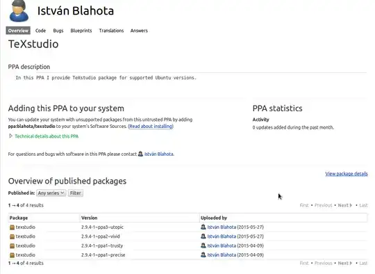

But if you look more throughly, you can find a PPA that seems to provide the last version:
Which provides the 2.9.4 version to Precise, Trusty, Vivid and Utopic.
You can find information on features, risks and how to use a PPA in What are PPAs and how do I use them?
