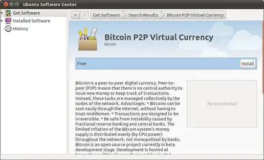

And a screenshot to finish it off:

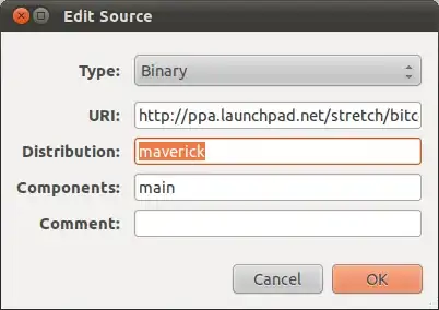

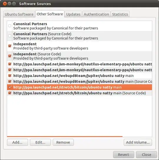

To change from 'natty' to 'maverick' for a PPA you can do this from the Ubuntu software center: usc
Click the bitcoin PPA and choose edit. Next it changing 'Natty' to 'Maverick': usc2
Reload the sources (it will prompt for it) and you should be able to install maverick's version of 'bitcoin'.
