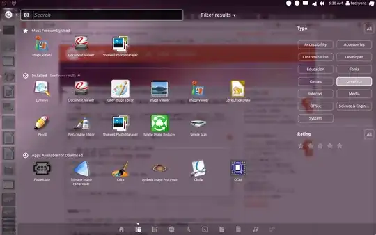

Else you can open application via the Unity dash
