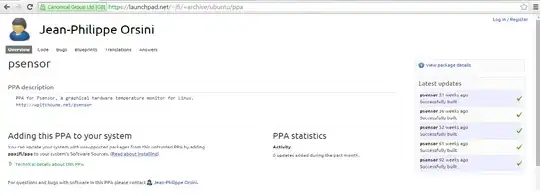

From Launchpad:
Personal Package Archives (PPA) allow users to upload Ubuntu source packages to be built and published as an apt repository by Launchpad
Launchpad is a website developed and maintained by creators of Ubuntu that allows users to develop and maintain open-source software.
If you have found a nice PPA and you want to add it to your repository, this is the general format:
sudo add-apt-repository ppa:user/ppa-name
Every PPA has its own page in Lanuchpad website. For example, the one mentioned in your post has its page here: https://launchpad.net/~jfi/+archive/ubuntu/ppa
If you look at the PPA's overview page, under the heading Adding this PPA to your system, you can see the location of PPA. See the below image:
You can use the location to replace ppa:user/ppa-name in the above command. So, in your case it is:
sudo add-apt-repository ppa:jfi/ppa
