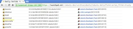

Please visit https://launchpad.net/~lubuntu-dev/+archive/ubuntu/lubuntu-daily. Here you'll find a collection of ppas (Personal Package Archives) provided by Lubuntu's development team. If you need to know more about ppas, you can look at What are PPAs and how do I use them?. You may also want to know about how to remove a ppa: How can PPAs be removed?.
Now to the specifics ...
The first link I provided offers an Overview of published packages along with a filter: in your case, you'd filter for "Trusty". You'll see that 62 packages are available for Trusty. One of them is lxterminal.

By the way, since you've mentioned "vivid" in the title of your question, you can run a filter using vivid instead of trusty. As of today, both trusty and vivid have the same version of lxterminal, AFAICT.
