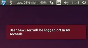

In the output we get the pid of the targeted user, that needs to be halted if the time exceeds the limit.
The solution
Assuming your user does not have sudo privileges:
This solution is a small background script. It limits the usage per day to a defined number of minutes, to set in the head of the script. Once set up (which is not too difficult) it runs very easy, and no additional action is needed afterwards.
To prevent unwanted data loss of possibly opened files, 60 seconds before the targeted user's time limit expires, a message will appear on his or her DISPLAY:
The script

  • Once per 10 seconds, the script looks if the targeted user is logged in. If so, it "adds" one "point" to a total usage, to be recorded in a file (/opt/limit/uselog). If the daily limit is reached, the script no longer allows the user to be logged in, kills its process if it exists.
  • On the day change (the date is recorded in a file, so reboot won't help), the log file is deleted, allowing a new amount of usage time to build up.
  • Since the script runs on boot up, from rc.local only user(s) with sudo privileges can stop the script, even then only if the user knows the process name.

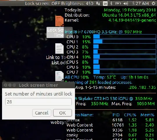

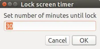

Lock Screen Timer
Create your own Screen Lock Timer instead of 3rd Party applications
Although there are 3rd Party applications to do this, you can create your own. Summary of steps:
  • Use gedit to create script lock-screen-timer
  • Copy and paste code from this window to lock-screen-timer
  • Mark lock-screen-timer as an executable
  • Test it!
  • Configure Nautilus to execute bash scripts
  • Create desktop shortcut link
  • Monitor time remaining
Open the Terminal using Ctrl+Alt+T and type:
gedit lock-screen-timer
Copy and paste code from window below to lock-screen-timer
Toggle back to this screen and copy the following code by highlighting it and pressing Ctrl+C:

Then toggle back to the empty gedit window and paste the code using Ctrl+V. Save the file and exit the editor back to the command prompt.
Now we need to make the script executable by typing:
chmod +x lock-screen-timer
Test It!
Before calling the script from the GUI, we'll call it from the terminal so we can see if any error messages are displayed:
~/lock-screen-timer
You are prompted for the number of minutes:
Lock Screen Timer
Set the desired number of minutes and click OK to start the timer. When there are 15, 10, 5, 3, 2 and 1 minute(s) left a system sound is heard and a message bubble appears advising when the screen will be locked. After the screen is locked you need to enter your password to unlock the screen.

Now you can double click on the desktop shortcut link and the script is run. A dialog box appears to get the number minutes. Two buttons are presented Cancel and OK. If you click the X to close the window it is the same as selecting Cancel.
After the timer is running and you double click on it again the first running copy is "killed". You can now start a new scren lock countdown or click Cancel for no countdown.
Display Time Remaining in systray / notification area
While lock screen timer is running it records how many minutes are remaining into the file ~/.lock-screen-timer-remaining. You can look at this file with the watch command or display it on Ubuntu's system tray / application indicator bar as shown at the top of this answer. To display time remaining in the notification area, follow the instructions in this Q&A: Can BASH display in systray as application indicator?.

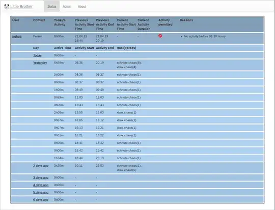

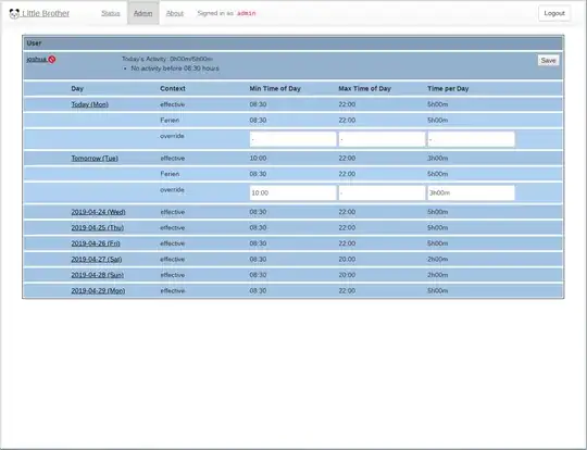

I've just released a beta version of my new application LittleBrother that is able to monitor play time on Linux machines. Test users are welcome to try the Debian package. Instructions on how to download and use it can be found here: https://github.com/marcus67/little_brother. The installation may still be a little rough, though. These are the features of the application:
  • Any number of users can be monitored.
  • Each user can have a specific set of rules defining the permitted playtime.
  • Rules can be adapted to "contexts", such as the day of the week and/or a vacation schedule (currently only the German schedules are supported).
  • Play time can be restricted to a time window (from, to).
  • A maximum play time per day can be defined.
  • Users can be forced to take a break after a certain maximum session time.
  • Users can be forced to wait for a miniumum break time after their activity.
  • Any number of Linux client hosts can be monitored (currently this requires users to have the same login on all machines).
  • There is a master host with a history of the activities of all users. This master host checks the rule sets and prompts the client hosts to terminate processes if required.
  • The master host offers a simple web interface for viewing the user activity over a configured history length (e.g. 7 days) and an administration page to dynamically define rule exceptions for a configured number of days into the future.
  • The web application can be run behind a proxy so that it will be accessible from away allowing remote administration after receiving calls from young users begging for more play time.
  • The application has international language support. Currently English and German translations are provided. Users are invited to provide translations for other languages.
  • The application uses voice generation to inform the user over impending forced logouts. Also these spoken messages are internationalized.
  • In addition to the time spent on Linux hosts the application can also monitor activity time on other devices such as smart phones or tables. It takes advantage of the fact that most modern operating systems put devices in some kind of power saving mode while they are not being used. This way, the network response (by pinging) can be used to determine the activity on those devices. In contrast to the Linux hosts, the application will not be able the terminate the activity. The play time, however, will be added to the overall playtime and hence will have an impact on the time allowed and also on the break time rules on the Linux hosts.
Some screenshots:
Status Page Administration Page
I tried timekpr but did not got it working. Then made a variant of it which works on my Ubuntu. This is what one needs to do for this variant:
  1. Add time limit in /var/lib/timelimit/user_to_be_limited.limit file with root rights only. e.g. 1800 for 1800 seconds (30 minutes) daily limit.
  2. Create /usr/local/bin/timelimit.sh with root rights with following:
    #!/bin/bash
    pollTime=30
    export DISPLAY=:0
    while(true); do
        sleep $pollTime
        usersLogedIn=$( users|sed -e 's/\s\+/\n/g'|sort|uniq )
        for userName in $usersLogedIn; do
            if [[ -e "/var/lib/timelimit/$userName.limit" ]]
            then
                if [[ ! -e "/var/lib/timelimit/$userName.time" || `( stat -c '%z'  /var/lib/timelimit/$userName.time|cut -c9,10 )` != `date +%d` ]]
                then
                    echo $pollTime > /var/lib/timelimit/$userName.time
                else
                    timeUsed=$(( `cat /var/lib/timelimit/$userName.time` + $pollTime ))
                    echo $timeUsed > /var/lib/timelimit/$userName.time
                fi
                if [[ `cat /var/lib/timelimit/$userName.time` -gt `cat /var/lib/timelimit/$userName.limit` ]]
                then
                    export XAUTHORITY=/home/$userName/.Xauthority
                    notify-send --icon=gtk-dialog-warning --urgency=critical -t 30000 "$userName" "You have 60 seconds left!"
                    sleep 60
                    pkill -u $userName
                fi
            fi
        done
    done
  3. Add to /etc/rc.local:
    sudo /usr/local/bin/timelimit.sh &
  4. Restart Ubuntu
