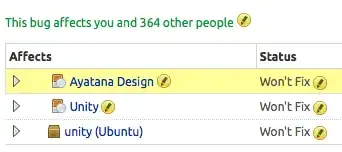

You can click on the "This bug affects me" part at the top, possibly popular opinion can have some impact.

It is currently Won't Fix status.
