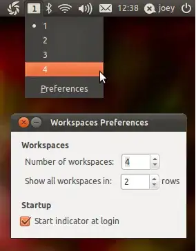

If you still can not use CCSM you could also add an indicator. See the image:
Add ppa:geod/ppa-geod to your Software Sources, update and then search for indicator workspaces or do a sudo apt-get install indicator-workspaces

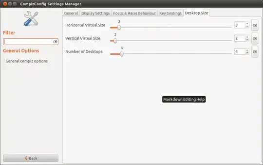

Did you change the horizontal and vertical size? These change the number of workspaces. I would have expected it to be 'number of desktops' but it is the other 2 you need to change ;-)
Desktop Size in general options
Like the image shows mine is 3 by 2.
