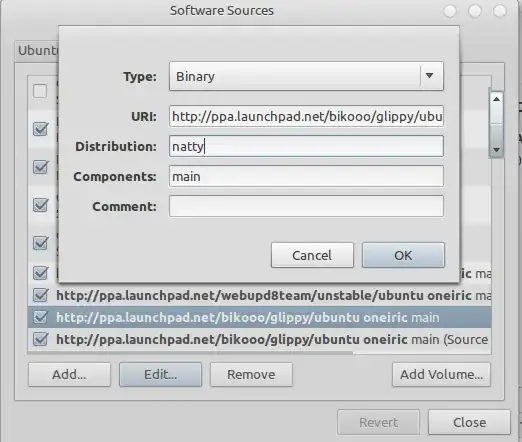

I took a look at the Glippy PPA and it seems that there is not yet a package for 11.10 yet.
If the project is active, they they should be up within a few weeks.
If you try to upgrade from 11.04 to 11.10, the older glippy package might work for you, but is not recommended.
If you want to do so in a fresh install, you can add the PPA, then edit the source to point to natty. Go to Dash -> Software Sources -> Choose your PPA -> Edit
Imgur
In my case it did not work, though, and I had to edit the /etc/apt/sources.list.d/bikooo-glippy-oneiric.list file manually.
To do that, Press Alt+F2 and type gksudo gedit /etc/apt/sources.list.d/bikooo-glippy-oneiric.list to launch gedit with the file. Replace the text oneiric with natty and save.
Of course you will need to run an update after this.
