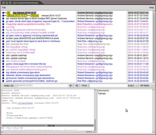

hg view is installed as part of the mercurial package, but not enabled by default to keep the package from depending on the tk toolkit. Install tk8.5, and the add the following to your "$HOME/.hgrc" file:
[extensions]
hgk=
Launch by running hg view in the repository folder. alt text
