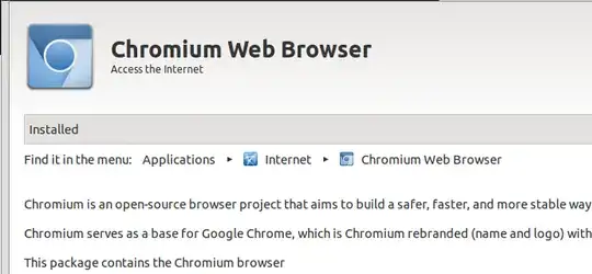

As far as I know after you have installed software using the software centre it tells you which menu it would be visible, in the detailed information section where you would rate the program. Image showing section of Ubuntu Software Center
