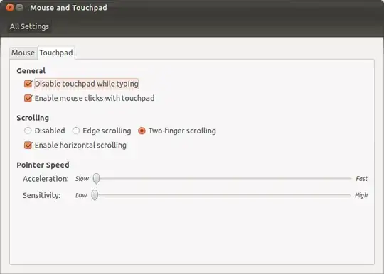

After the reboot, you'll want to update/tweak your touchpad settings.
Head to System Settings > Mouse and Touchpad, and then switch to the touchpad tab, and you'll see something like this:
You can play around with those settings as much as you want, just so you can figure out what works best for you.
