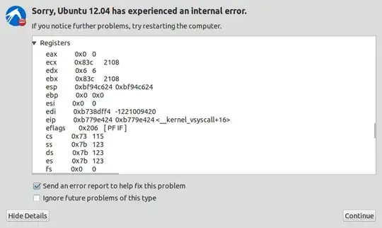

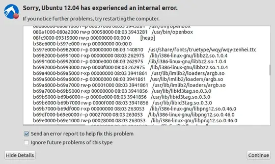

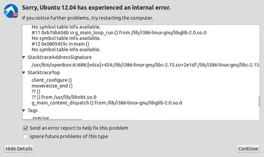

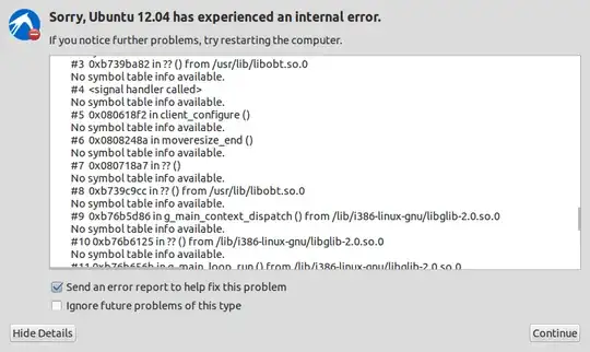

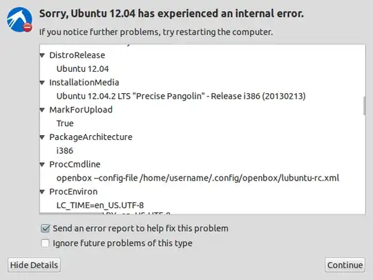

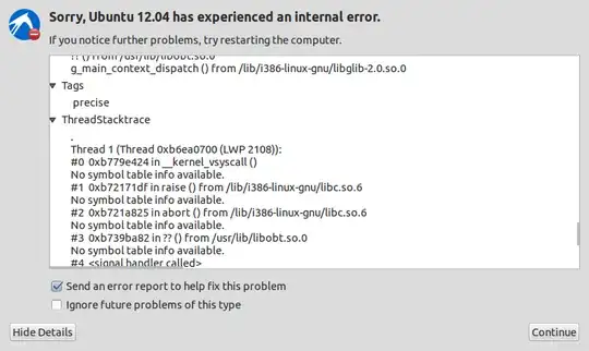

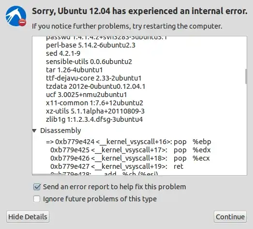

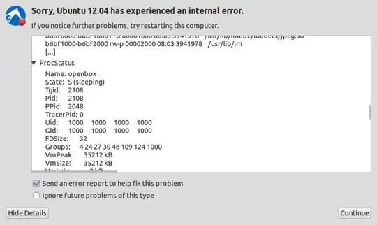

I get this error constantly, and i don't know what should i do :(
I use the lubuntu 12.04
does lxde come with openbox, i don't know whether i have installed openbox.
PS.i found when i right-click the gnome-terminal, the screen flashed and the error occurs.

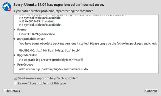

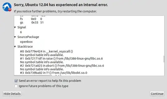

The openbox version (L)ubuntu 12.04 ships with is known to have issues with crashes when using GTK 3 applications. What worked for me was adding this PPA with updated Lubuntu packages.
Please make sure to read through these before adding new PPAs:
What are PPAs and how do I use them?
Are PPA's safe to add to my system and what are some "red flags" to watch out for?
If you are ready to proceed you can add the PPA and upgrade your system with:
sudo add-apt-repository ppa:mati75/lubuntu
sudo apt-get update
sudo apt-get upgrade

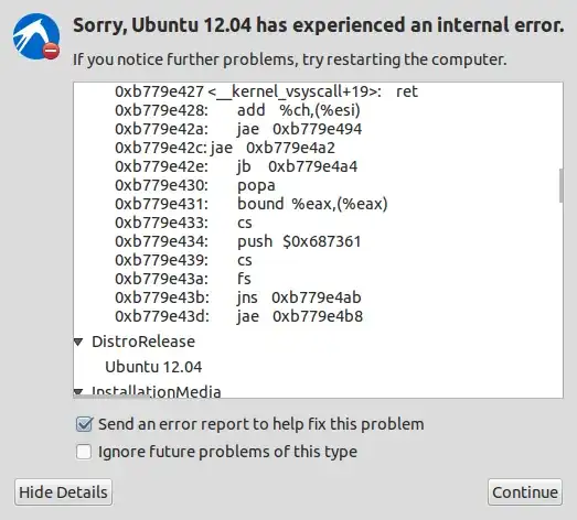

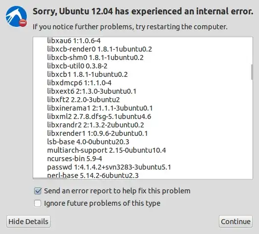

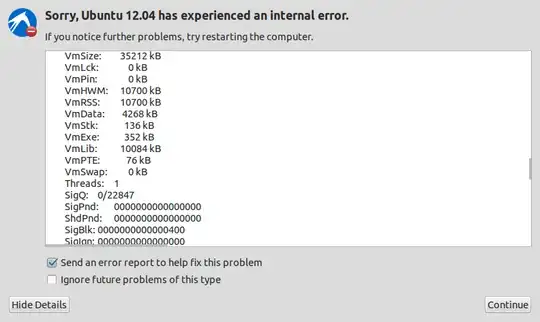

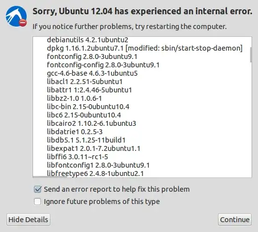

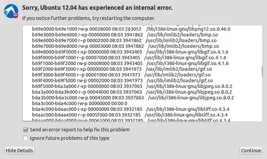

P.S.: You can safe yourself a lot of work if you just copy paste the error log next time. It must have taken you ages to take these screenshots!
Glutanimate
  • 21,763

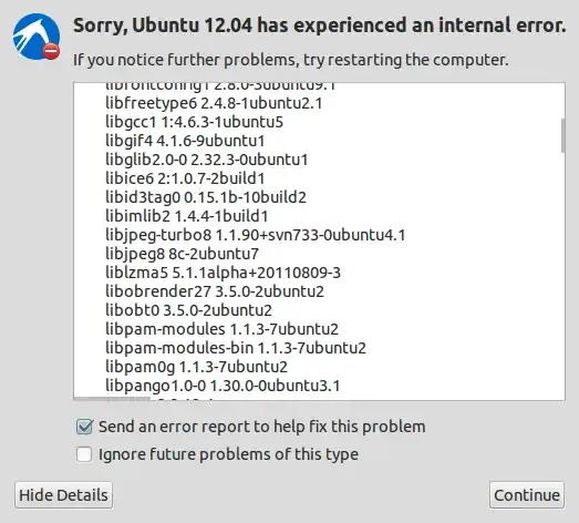

Normally, bug reports are off-topic here, but as Glutanimate said, you should probably use the PPA to fix that crash. But still, in the report says that you have Obsolete packages and that's why you can't report the bug.
You must upgrade your system packages and go with Glutanimate solution. If you don't do so, you will expect more of this error (or others). The key to solve bugs is keeping your system update.
