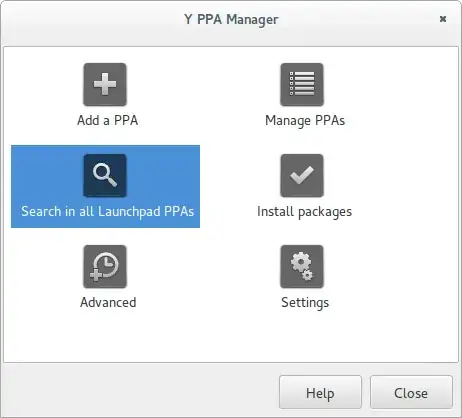

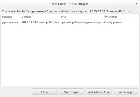

y-ppa-manager can do that for you:
sudo add-apt-repository ppa:webupd8team/y-ppa-manager
sudo apt-get update
sudo apt-get install y-ppa-manager
Search the package and use the button Add selected PPA to add the PPA.
