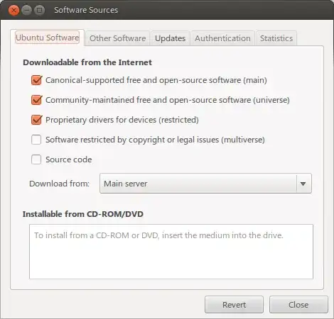

For build-essential go to update manager > settings > ubuntu softwares and see if top main is checked.
