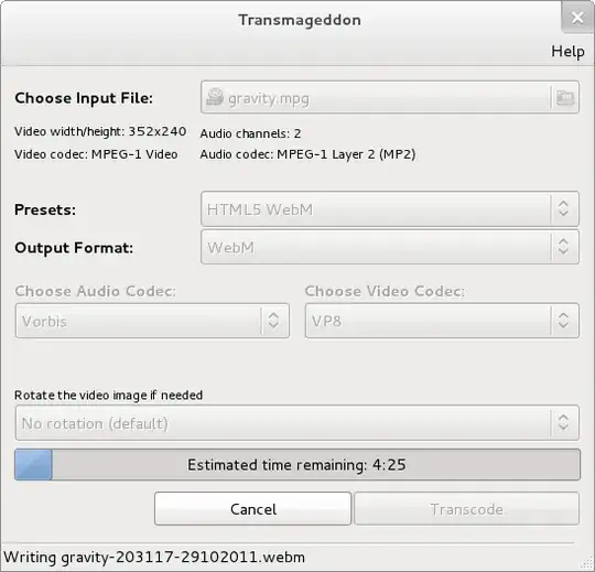

Transmageddon
Transmageddon supports almost any format as its input and can generate a very large host of output files. The goal of the application was to help people to create the files they need to be able to play on their mobile devices and for people not hugely experienced with multimedia to generate a multimedia file without having to resort to command line tools with ungainly syntaxes.
The currently supported codecs are:
Containers:
  • Ogg
  • Matroska
  • AVI
  • MPEG TS
  • flv
  • QuickTime
  • MPEG4
  • 3GPP
  • MXT
Audio encoders:
  • Vorbis
  • FLAC
  • MP3
  • AAC
  • AC3
  • Speex
  • Celt
Video encoders:
  • Theora
  • Dirac
  • H264
  • MPEG2
  • MPEG4/DivX5
  • xvid
  • DNxHD
It also provide the support for the GStreamer's plugins auto-search.

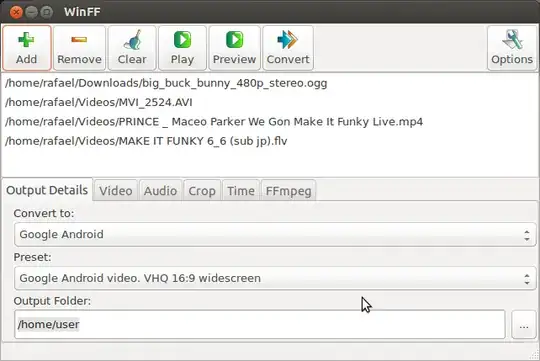

Winff
WinFF is a graphical user interface for FFmpeg. It will convert almost any video file that FFmpeg will convert. WinFF does multiple files in multiple formats at one time. You can, for example, convert mpeg's, flv's, and mov's into avi's (or DVD/VCD format or MPEG or 3gp etc.) all at once.
This package provides a variety of preset conversion settings for common formats and devices. These presets are intended to hit the "sweet spot" for each individual codec. They have been written with a tip of the balance to quality.

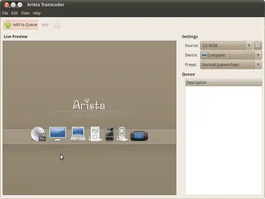

Arista
Arista is a simple multimedia transcoder, it focuses on being easy to use by making complex task of encoding for various devices simple.
Users should pick an input and a target device, choose a file to save to and go. Features:
Presets for iPod, computer, DVD player, PSP, Playstation 3, and more.
Live preview to see encoded quality.
Automatically discover available DVD media and Video 4 Linux (v4l) devices.
Rip straight from DVD media easily (requires libdvdcss).
Rip straight from v4l devices.
Simple terminal client for scripting.
Automatic preset updating.

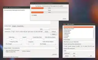

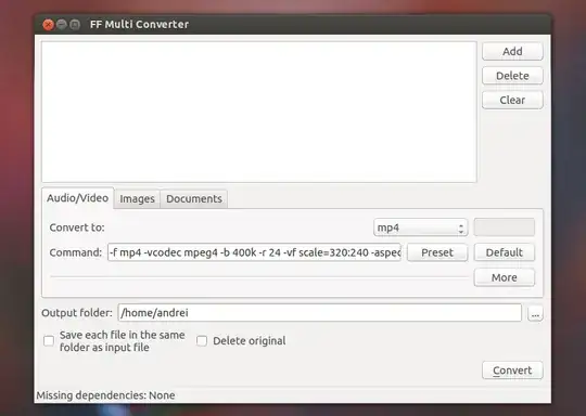

Convert Audio, Video Files With FF Multi Converter
FF Multi Converter supports the following formats:
audio/video: aac, ac3, afc, aiff, amr, asf, au, avi, dvd, flac, flv, mka, mkv, mmf, mov, mp3, mp4, mpg, ogg, ogv, psp, rm, spx, vob, wav, webm, wma, wmv;
Install FF Multi Converter in Ubuntu
sudo add-apt-repository ppa:ffmulticonverter/stable
sudo apt-get update
sudo apt-get install ffmulticonverter
