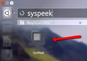

To install, just press Ctrl+Alt+T on your keyboard to open Terminal. When it opens, run the commands below:
wget -O syspeek_0.2_all.deb https://launchpadlibrarian.net/83623660/syspeek_0.2~oneiric1_all.deb
sudo dpkg -i syspeek_0.2_all.deb
When done search for syspeek in dash, and you will get:
Source:Upubuntu
