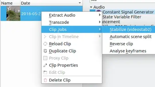

You can easily stabilize videos with Kdenlive:
Right-click on a clip in the project library and select Clip Jobs -> Stabilize
Worked with Kdenlive 20.08.2 on Ubuntu 20.10

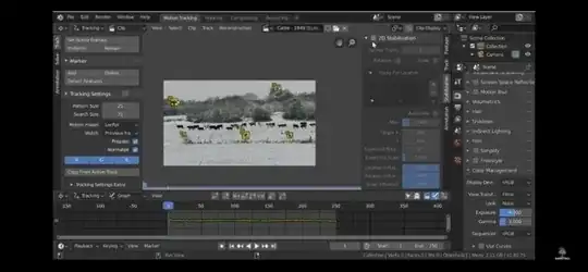

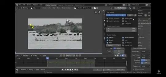

Blender is a free and open-source 3D creation suite. You can define tracking points to remove shakiness, bumps and jerks from video footage using the 2D video stabilization feature.
To install Blender Run:
sudo apt update
sudo apt install blender
Alternatively, The latest version (3.0.1) can be Downloaded from the Blender Website.
Video stabilization instructions are documented in the Blender 3.0 Manual
Here is a basic overview to use the Stabilization Feature:
  1. Tap on "open" to load the video clip.
  2. Click on the "set scene frame" located on the left to generate the video timeline.
  3. Click on "Tracking settings" and select locRot. Add as many markers as you want for location and rotation.
  4. Now click on the "Stabilization" tab to enable 2D stabilization.
  5. Select the tracks for location and rotation you marked earlier.
  6. Tap on "clip display" located at the top and select "show stable".
  7. Now click on "Autoscale". Or if you prefer to adjust according to your preference then you can move the slider to get the desired results.
  8. Play the video and enjoy the stable version of your footage.
  9. Tap on "save" to save the video clip.
