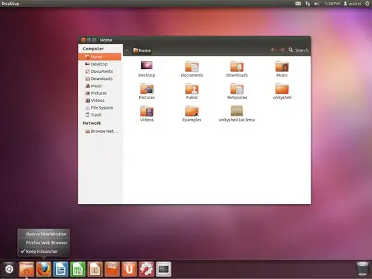

There is now an unofficial Compiz Plugin that allows you to move the Unity 3D (not Unity 2D) launcher from the left to the bottom.
Credit to WebUpd8.
In summary:
  1. You can now peruse the source-code. Contact the maintainer with suggested fixes! Remember this is unofficial and can & probably will have many bugs still to be ironed out.
  2. Install the PPA - ppa:paullo612/unityshell-rotated
  3. The packages to install are unityshell-rotated libnux-1.0-0
  4. A new plugin Ubuntu Unity Plugin Rotated will be made available in CCSM
  5. There is a likelihood of freezes on installation. If this occurs use CTRL+ALT+F1 to start a TTY, login and restart lightdm with sudo service lightdm restart. Rerun ccsm to enable the new plugin
  6. This plugin replaces the official Unity Plugin. You will obviously not receive further bugfixes from the Ubuntu development team - you will be reliant on the PPA maintainer to supply bug-fixes
warning please see this Q&A as to potential stability issues using CCSM

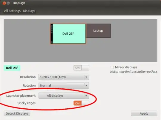

  • You can, at least, have some control over the launcher in a multi-monitor setup:
Unity launcher multi-monitor settings
(image edited from Ubuntu Vibes)

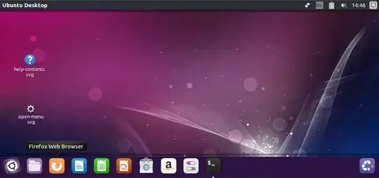

If you are using Ubuntu 16.04 you can run the following command in terminal to move the unity launcher to the bottom:
gsettings set com.canonical.Unity.Launcher launcher-position Bottom
If you want it in the default location (left of the screen), run:
gsettings set com.canonical.Unity.Launcher launcher-position Left

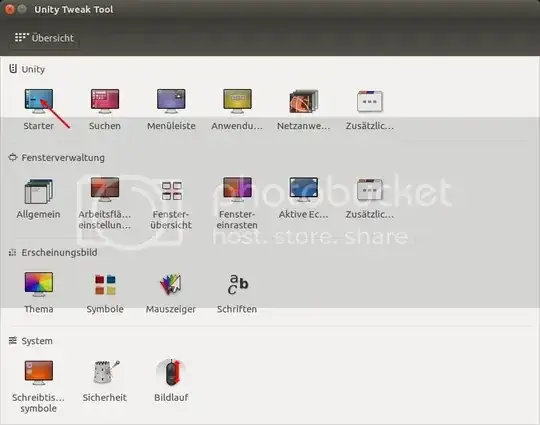

You will be greeted by the following window where you need to access the Starter (called Launcher in english) tab (see arrow):
unity-tweak-tool-1

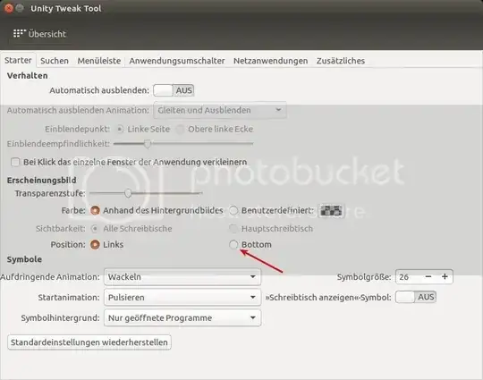

In the starter tab then you will see the option to move the Launcher to the bottom (see arrow in following picture):
unity-tweak-tool-2

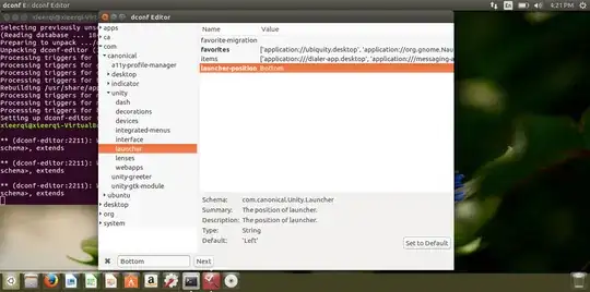

Another possible solution - via dconf-editor , the schema is com.canonical.Unity.Launcher
To install dconf-editor run sudo apt-get install dconf-editor in terminal , or find it in the new software center
