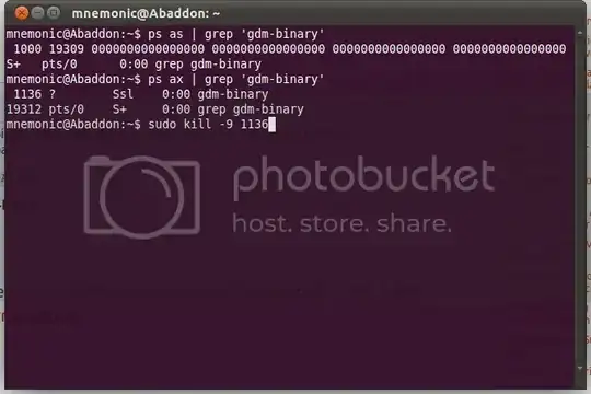

If you want to install the binary that comes directly from Nvidia, I can tell you how I have accomplished this in the past.
  1. Switch to TTY CTRL-ALT-F1
  2. Find the PID for gdm-binary (e.g., ps ax | grep 'gdm-binary')
  3. Kill associated PID for gdm-binary (e.g., sudo kill -9 1136)
With X shutdown, you are ready to install the binary from Nvidia. Please use the appropriate name for the binary you are attempting to install. The following example is using the NVIDIA-Linux-x86_64-270.41.19.run binary downloaded from Nvidia:
`sudo sh ./NVIDIA-Linux-x86_64-270.41.19.run`
