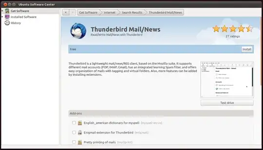

Why install the tar version of Thunderbird?
Thunderbird is available in Ubuntu Software Center:
tbird
This is the best version for Ubuntu and has been tested by many many users before you.
