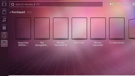

blade19899
  • 26,994
Please read the below note first if you are on 12.04!
Note: Ubuntu TV is in an "experimental" state for 12.04 right now; install it at your own risk. No currently working (with 12.04) PPA is available, and you must build from source.
It only functions on 11.10; it does not fully work on 12.04, and is not designed to. Its current state is in flux because "Unity 2D, on which it is based, is being decommissioned."
The instructions below were adapted in part from two now-somewhat-obsolete sources: the Community/Contributing page, and blade19899's old answer above.
  • Install the prerequisites and build dependencies:
    sudo apt-get build-dep unity-2d
    sudo apt-get install bzr dconf-tools ffmpeg gnome-common libdeclarative-multimedia
  • The official UbuntuTV trunk has not been updated since November 2011 and does not compile on 12.04. So we get our source from what appears to be the latest branch of lead dev Michał Sawicz, updated June 2012., and build it:
    mkdir ~/ubutvsrc && cd ~/ubutvsrc
    bzr branch lp:~saviq/ubuntutv/precise_merge
    cd precise_merge
    cmake .
    make
    cd ..
  • Install the alternate unity-lens-video:
    bzr branch lp:~ubuntutv-dev-team/ubuntutv/unity-lens-video
    cd unity-lens-video
    ./autogen.sh --prefix=/usr --sysconfdir=/etc
    sudo make install
    cd ..
  • Create the Video sub-directories:
    mkdir -p ~/Videos/unity/local/featured
    mkdir -p ~/Videos/unity/local/rented
    mkdir -p ~/Videos/unity/local/recorded
    mkdir -p ~/Videos/unity/local/purchased
  • Create thumbnails and settings:
    /usr/lib/unity-lens-video/create_tmb.sh ~/Videos/
  • Set the dconf key:
    GSETTINGS_SCHEMA_DIR=~/ubutvsrc/precise_merge/data gsettings set com.canonical.Unity2d form-factor tv
  • Start the Ubuntu TV interface!
    • If you are already using Ubuntu 2D, first kill these processes with:
    killall unity-2d-{panel,places,launcher,spread} && killall unity-2d-{panel,places,launcher,spread}
    and then start the Ubuntu TV UI with ./shell/app/unity-2d-shell -opengl
    • If you are using Unity (Ubuntu 3D) or Gnome-Shell instead, first disable the default window manager with:
    metacity --replace &
  • You can close it with Alt+F4, or with Ctrl-C in the parent terminal.
  • To restore your default desktop environment:
    • Run sudo apt-get --reinstall install unity-lens-video
    • If you were using Unity or Gnome-shell, run unity --replace or gnome-shell --replace
    • If you were already using Ubuntu 2D, first run gsettings reset com.canonical.Unity2d form-factor, then logout or reboot, using sudo reboot if necessary.
